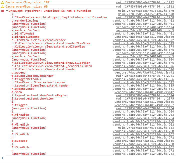

Please can you check the dev console for incriminating errors? Let me know if you need steps/help on how to do that. Thanks, and apologies for the regression.
i have the same issue any ideas on how to fix it?
Please check your developer console in Chrome (if that’s what you’re using) and paste any error messages in here - I can’t (yet) reproduce the issue on our side. Thanks!
There is definitely something failing, this is what I get from when I selects playlists

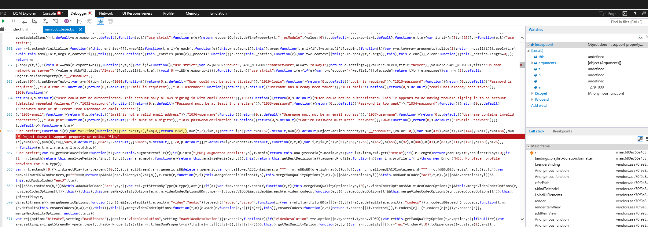

As I mentioned ie has the same issues
This is failing for me for movie playlists as well. Playlists page may come up, but is empty. Total # of playlists is displayed when the “All” filter when the page is first accessed, but selecting any other filter value results in a total # of 0, nothing is displayed, and subsequently switching back to the “All” filter then results in a total of 0 and nothing shown. Appears really broken in this latest release…
Seeing the same JS error as the above poster (I think). In the console in IE, I see the same “Object does not support property or method ‘find’” exception:
