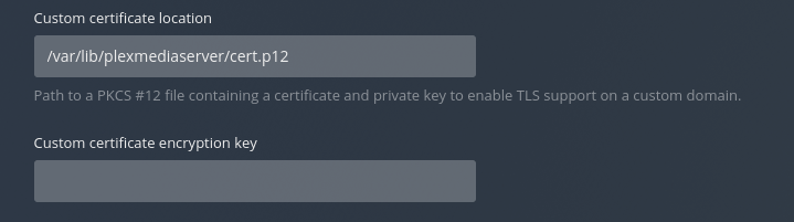

I imported crt here
file reader permission is ok
custom server access URLs is https://domain.tld ( without ‘www’)

If I understand correctly cloudflare has two type of certificate :
Edge certificates are provided by Cloudflare and shown to your visitors. They will encrypt traffic between your visitors and CF. Origin is a certificate on your server and needed to encrypt traffic between your server and Cloudflare >>
my crt in /etc/ssl are “origin certificate” and they are pem format. Does Plex only accept PKCS #12 format ?
Edit:
Converted to PKCS #12 with no password
but it’s still red
I think it will accept PEM but not 100% on that.
I use P12 format.
You can verify the cert is being picked up by restarting PMS (DEBUG logging enabled), wait about 1 minute, then pull the logs.
You’ll see where PMS either imports (pins) or rejects the cert

Apr 28, 2022 22:02:36.076 [0x7f7a5dfa6b38] ERROR - [CERT] Found a user-provided certificate, but couldn't install it.
I tried again with P12 format and with password but It can’t install that certificate
Stupid question: Permissions are such that plex:plex can read it and you gave it the password?
(It does need the password . it doesn’t like a blank password)
No silly question…my fault I added the password . I changed path and I didnt check chown
