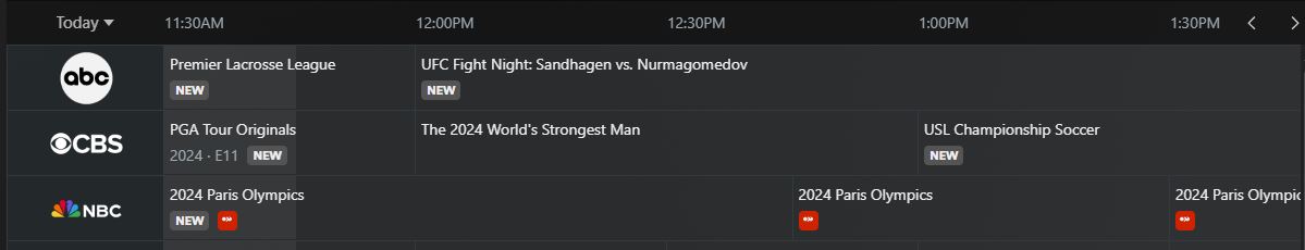

@BigWheel Missed recording. It’s set to NEW and it’s not recording. My system is supposed to be recording everything today. And it stopped recording at 10am and will not start again until 12:45. This is not supposed to happen. I don’t know why it is happening. It shows in my guide as being scheduled. But my DVR schedule doesn’t have it. Given it’s New and shows as being scheduled, this is very frustrating. Screen shots included.
Do you have the logs from when it should have started recording?
