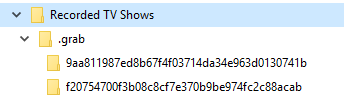

My problem is when plex tries to write files for a scheduled recording. It fails giving “An unknown error occurred” yellow exclamation. The errors I’m seeing from the media server log are below. I feel like the problem is in the permissions or actions allowed via the cifs mount that plex is trying to use, but can’t. I’ve tried googling around for cifs errors relating to determining disk space or such things, but I’ve come up empty. For what it’s worth, plex does write some folders successfully, but the folders are all empty:
folders
