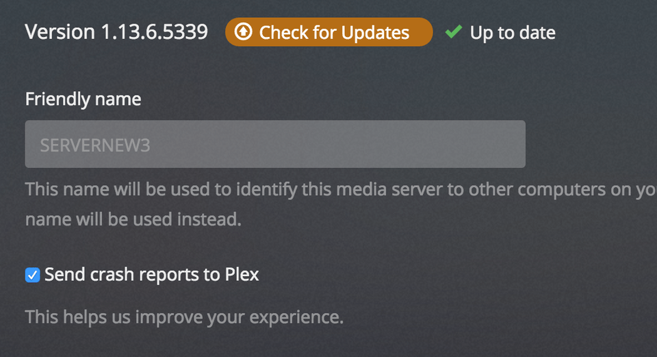

Seems to crash every single time on ay 4K and/or TrueHD file format.
See also: Stability issues with 1.13.6.5339

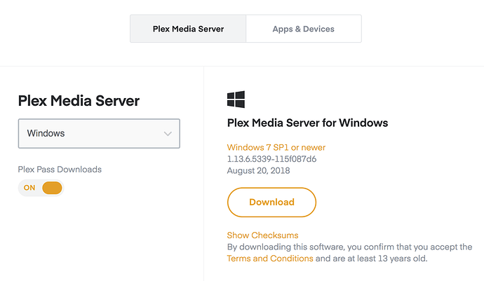

Also, this is a beta version. It’s going to have issues and if you’re using it, the idea is that when you do run into issues, you’re going to report them and most likely provide logs.
You can download/install the most recent stable version, which is: 1.13.5, from https://www.plex.tv/media-server-downloads/ (turn off Plex Pass Downloads).
Thank you for pointing that out. Is that written down definitively somewhere? The reason I ask is, nowhere in the download UI is it implied Plex Pass downloads are unstable or unsupported.
My impression was the Plex Pass enabled download was an officially support build with feature enabled for subscribers. My assumption was based on the available documentation is beta builds could be prevented by using the Server Settings, General, Download Channel. There is also no visual differentiation in the server settings if you are on a beta or supported build.
