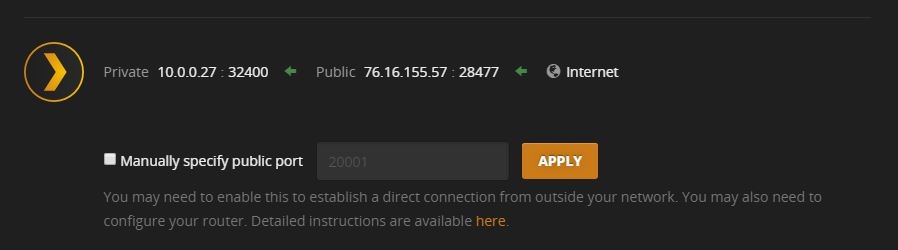

I’ve added a ‘service’ in the Port Forwarding section of the Gateway configuration, for port 20001, and then assigned 20001 as the manually specified public port in Remote Settings. When I first Apply that port, I get a message that my server is fully accessible outside the network. But when I revisit the page to check, I see 'Not available outside your network. Your server is signed in to Plex, but is not reachable from outside your network. '.
When my brother then tries to access my server, he’s told it can’t be reached directly so an indirect connection is established. Which I interpret to mean Port Forwarding has not been set up correctly. He has no buffering issues so far, but from what I’ve read he’s only getting 2 Mbps from the Relay. Not the way I want to go.
So … if anyone has experience in setting up Port Forwarding & Plex with the Arris, please chime in!

This is the default port set up for Remote access to my server. Would it matter if Comcast is throttling 32400 anyway? Isn’t 28477 the port that is exposed to the outside world?
Yes, in this case your ISP only sees traffic on port 28477, not on 32400.
Though you cannot rule out that they by now have developed a way to identify Plex traffic by other means than the port number.
So doesn’t this make the whole throttling discussion around 32400 moot?
