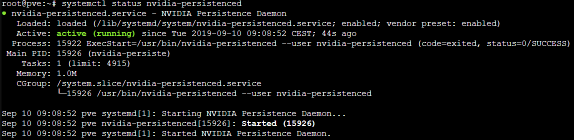

Hi, love your guide, but had a problem after finishing all the steps, without any failure.
So I can see my GTX960 in the LXC (Ubuntu) and “nvidia-smi” is working well in there. But when I run a movie/series etc. and starting transcoding using the HW acceleration, the GPU does nothing (Well, the memory start filling a little bit, but just about 0-1% GPU-Utility).
I know that the GPU can handle >20x transcoding 1080p → 240p, because I get it run before, but after upgrading my machine I don’t know my steps done before :confused:
Hope someone can help me with this problem.
Are you looking at nvidia-smi in the LXC container or the host?
It won’t show any activity in the LXC container while transcoding, you’ll have to look at it on the host to see if it’s transcoding.
I was look on the host, as well as on LXC.
Here are some pictures, which show that the HW acceleration is (more or less) just working on two streams. While going through your ‘guide’ the patch also said “Patched!”.
Yesterday I also have redone all the steps, but it was giving the same result.
I wouldn’t say that’s unusual, I get 0% utilization on my 980Ti decoding and encoding from 1080p to SD h264.
image image
Okay, so it seems a problem with the patch.
Do you know a way to fix this problem? I’m not sure what I have made wrong…
Here are the results of the “patch-steps”:
I’m not sure why you think something is wrong. Everything you’ve shown looks like it works to me.
Well, it is still not working, so something need to be wrong :stuck_out_tongue:
I will try to find a solution and then port it here :wink:
@evomod It’s perfectly normal for the nvidia-smi utility to show 0% GPU activity while transcoding. It is only showing you a point in time snapshot of activity of the GPU. And since the transcoder does not keep a sustained load running on the GPU (because the GPU can transcode several times faster than real time, which is the point) the GPU/hardware transcoder will go idle after it has a filled a buffer that matches the setting you have in ‘Transcoder default throttle buffer’. Which typically will only take a few seconds. Then after some percentage of that buffer is depleted from playback, it will burst again to refill it. If you’d like to watch activity of the GPU as you start a transcoded stream to see this in action, use this command:
watch -n 2 -d -c ‘nvidia-smi -q -d UTILIZATION’
As far load goes, think about it, if your GPU can handle 20 simultaneous transcodes and you’re only running 2, it’s going to be idle AT LEAST 90% of the time.
I found my problem and solved it.
The instruction @constiens has given were 100% right.
I can not say why, but I have made a mistake with the
ls -l /dev/nv*
The output was “195” for nvidia-modeset and “236” for nvidia-uvm.
But I typed 234 instead of 236 in for the LXC.
I thought I have checked everything twice, but forgot about this command.
My bad … Thank you guys :wink: .
