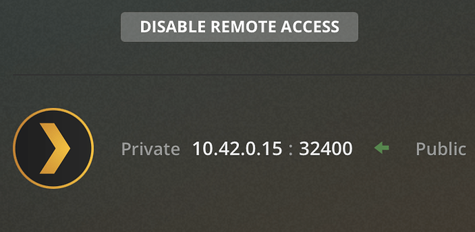

thank you for your response. I have uploaded the screen shots. Yes, no spaces, tabs or funny characters. What baffles me is that it works fine on my MacBook Pro which is on 192.168.1.0/24 network (same is iOS and Apple TV)
What’s even weirder is that you actually disabled the use of the Plex Relay for your server.
yes, that’s what I wanted to try because Relays inherently are bandwidth limiting.
is it normal for plex docker to point to docker ip instead of normal 192.168.0.0/24?
depends on your docker container configuration
I was right. the external ip was pointing to docker IP. So I re created the docker container with net option to be host i.e. use the host network space. if you’re using rancher with Kubernetes then this option is available in advanced and then networking.
Once done, all devices are blasting through my gigabit network :slight_smile:
Once this option was selected, all I had to do was to add 192.168.1.0/24 in the LAN Networks as shown in my uploaded image. And it behaved accordingly.
