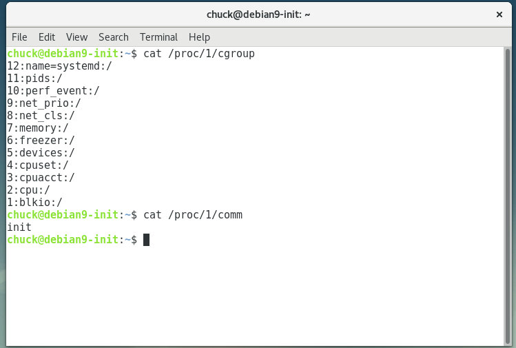

Where one can get totally thrown off base is with Debian
I migrated to using /proc/1/cgroup so I don’t have to name-chase everyone’s docker executive.
It’s equally impossible to name-chase everyone’s LXC executive.

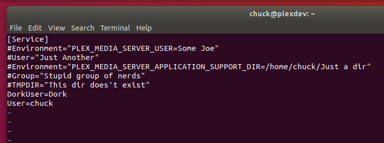

I have a systemd override conf file where I set a bunch of custom settings, and the preinst script seems to be getting confused by some of them. Here’s my override file in its entirety:
[Service]
ExecStartPre=
ExecStartPre=/bin/mkdir -p "${PLEX_MEDIA_SERVER_APPLICATION_SUPPORT_DIR}"
ExecStart=
Environment=LD_LIBRARY_PATH=/usr/lib/plexmediaserver/lib
Environment=PLEX_MEDIA_SERVER_INFO_VENDOR="Ubuntu"
Environment=PLEX_MEDIA_SERVER_INFO_DEVICE="PC"
Environment=PLEX_MEDIA_SERVER_INFO_MODEL="x86_64"
Environment=PLEX_MEDIA_SERVER_INFO_PLATFORM_VERSION="19.10 (Eoan Ermine)"
ExecStart="/usr/lib/plexmediaserver/Plex Media Server"
ProtectHome=true
PrivateTmp=true
ProtectControlGroups=true
ProtectKernelTunables=true
ProtectKernelModules=true
ProtectSystem=full
PrivateUsers=true
DeviceAllow=char-DVB rw
DeviceAllow=char-drm rw
DevicePolicy=closed
InaccessiblePaths=/mnt/games /mnt/backup /boot
SystemCallFilter=~@clock @cpu-emulation @debug @keyring @mount @obsolete @privileged @reboot @setuid @swap
SystemCallErrorNumber=EPERM
#SecureBits=noroot-locked
CapabilityBoundingSet=
  1. When the preinst script is looking for User, it’s getting matched with PrivateUsers, gets the value of true, sees that there’s no such user, and complains.
  2. When the preinst script is looking for Group, it’s getting matched with PrivateControlGroups, gets the value of true, sees that there’s no such group, and complains.
  3. The preinst script sees that I have a LD_LIBRARY_PATH setting there, but that’s because I like to keep the ExecStart field clean, and have environment variable settings go as separate entries in their own fields. I get the reasoning for the error, but any chance there can be an override setting to say “Don’t check my settings, I know what I’m doing”?
Also, systemd shouldn’t have the “d” at the end capitalized. See this page.
Also, rather than manually parsing these files, I think systemctl can be used to get the values (presumably, if .service files are being installed, systemctl will exist). Something like systemctl show -p User plexmediaserver should work (hopefully in containers as well).

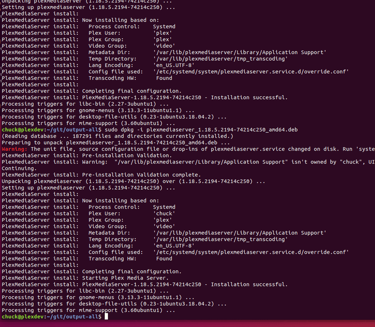

Which environment is this being used on ? (I see the ubuntu)
As for the SystemD , thanks for catching those typos. (there were 2)
I’m doing a lot of bullet-proofing now.
I think I see where the grep can be tightened as part of the regex to improve.
As FYI, hard setting the variable PMS picks up dynamically is against their purpose.
You also have LD_LIBRARY_PATH – It’s now illegal given RPATH is defined.
Confusion between PrivateUsers and Users, or any other wording combination has been corrected.
DorkUser is no longer considered.

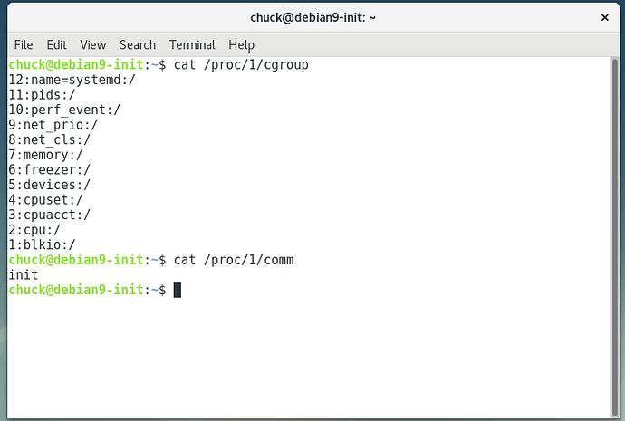

Is it init or is it upstart or was the system upgraded from Ubuntu 15 ?
Please go look at where pid 1’s executable is pointing. and what it’s value is.
I don’t support upstart anymore because Ubuntu dropped it in 2016.
it was a “one release wonder”
Here is the actual code to the test I perform:
  # If this looks like init,  be careful of redirectioon
  elif [ "$(cat /proc/1/comm)" = "init" ]; then
    # Verify not a redirected init -> systemd
    if [ "$(readlink /sbin/init)" = "" ]; then
      Init=1
    elif [ $(readlink /sbin/init | grep systemd | wc -l) -gt 0 ]; then
      Systemd=1
    else
      Output both "Unsupported init/systemd hybrid control configuration."
      exit 1
    fi
