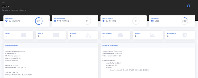

I use LXC over Docker because it’s a (paraphrasing) “ultra-lightweight VM without the overhead of a VM”. I don’t suffer the typical type 1/type 2 virtualization problems because I’m still using the native host kernel – just in a different kernel namespace.
Below are my LXCs. Each things its a peer on my LAN just as if it were a VM.
[chuck@glockner ~.2000]$ lxc list
|     NAME      |  STATE  |        IPV4         |                    IPV6                    |   TYPE    | SNAPSHOTS |
| homebridge    | RUNNING | 192.168.0.85 (eth0) | 2601:985:500:360:216:3eff:feb9:2726 (eth0) | CONTAINER | 0         |
| librenms      | RUNNING | 192.168.0.84 (eth0) | 2601:985:500:360:216:3eff:fed1:be2a (eth0) | CONTAINER | 1         |
| lxd-dashboard | RUNNING | 192.168.0.80 (eth0) | 2601:985:500:360:216:3eff:fe2a:4752 (eth0) | CONTAINER | 2         |
| media         | RUNNING | 192.168.0.81 (eth0) | 2601:985:500:360:216:3eff:fe84:91e6 (eth0) | CONTAINER | 2         |
| plex          | RUNNING | 192.168.0.82 (eth0) | 2601:985:500:360:216:3eff:fe4d:cfa3 (eth0) | CONTAINER | 0         |
[chuck@glockner ~.2001]$

LXC setup is like setting up any host except partitions are ‘host directory maps’.
You get the command line base OS by default.
LXD-dashboard does the bulk of the work through the GUI.
You can run lxc via the command line or use the GUI.
Once you start a container, it restarts with the host unless otherwise configured.
You can do clustering with this. It’s extremely powerful for folks like us.
