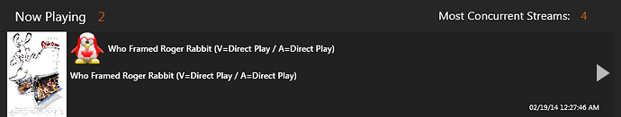

Low Priority request - You’ve given us the option of changing our Notification Titles and Notification Messages (which work as expected) but maybe made some more work for yourself to please all of us who just can’t leave things alone.
In my case, I have the Video, VideoDecision and AudioDecision as the “Playing Title”, and Username is watching Video on Player in the “Playing Message.” The Now Playing section of the Stats page seems to only read the modified “Playing Title”, and displays it twice. Maybe we could get the second one to reflect the changes we make to the Playing Message.

Low Priority request - You've given us the option of changing our Notification Titles and Notification Messages (which work as expected) but maybe made some more work for yourself to please all of us who just can't leave things alone.
In my case, I have the Video, VideoDecision and AudioDecision as the "Playing Title", and Username is watching Video on Player in the "Playing Message." The Now Playing section of the Stats page seems to only read the modified "Playing Title", and displays it twice. Maybe we could get the second one to reflect the changes we make to the Playing Message.
Your work on this project is fantastic, and I look forward to each and every new version.
This is a bug I'll fix it.
