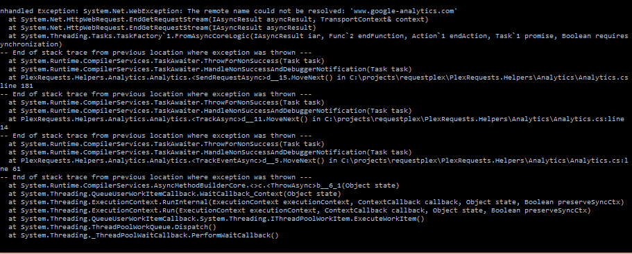

I’m getting the 500 error on the Admin -> Status page as well. Linux running on an Asustor AS-7004T NAS.
Just fyi… Your Google Analytics implementation is causing an error on a fresh install.
Win10 BTW…
That’s strange, never encountered that error before. Thanks for reporting it, I’ll make sure I add some better error handling around that. You can always turn off the analytics in the settings.

at System.Reflection.RuntimeMethodInfo.UnsafeInvokeInternal(Object obj, Object[] parameters, Object[] arguments)
at System.Reflection.RuntimeMethodInfo.Invoke(Object obj, BindingFlags invokeAttr, Binder binder, Object[] parameters, CultureInfo culture)
at Owin.Loader.DefaultLoader.<>c__DisplayClass12.b__b(IAppBuilder builder)
at Owin.Loader.DefaultLoader.<>c__DisplayClass1.b__0(IAppBuilder builder)
at Microsoft.Owin.Hosting.Engine.HostingEngine.ResolveApp(StartContext context)
at Microsoft.Owin.Hosting.Engine.HostingEngine.Start(StartContext context)
at Microsoft.Owin.Hosting.Starter.DirectHostingStarter.Start(StartOptions options)
at Microsoft.Owin.Hosting.Starter.HostingStarter.Start(StartOptions options)
at Microsoft.Owin.Hosting.WebApp.StartImplementation(IServiceProvider services, StartOptions options)
at Microsoft.Owin.Hosting.WebApp.Start(StartOptions options)
at Microsoft.Owin.Hosting.WebApp.Start[TStartup](StartOptions options)
at PlexRequests.UI.Program.Main(String[] args) in C:\projects\requestplex\PlexRequests.UI\Program.cs:line 93
Unhandled Exception: System.Reflection.TargetInvocationException: Exception has been thrown by the target of an invocation. —> System.Reflection.Tar
getInvocationException: Exception has been thrown by the target of an invocation. —> System.NullReferenceException: Object reference not set to an i
nstance of an object.
at PlexRequests.Core.Migration.Migrations.Version1100.UpdateDb(IDbConnection con) in C:\projects\requestplex\PlexRequests.Core.Migration\Migrations
\Version1100.cs:line 247
at PlexRequests.Core.Migration.Migrations.Version1100.Start(IDbConnection con) in C:\projects\requestplex\PlexRequests.Core.Migration\Migrations\Ve
rsion1100.cs:line 76
— End of inner exception stack trace —
at System.RuntimeMethodHandle.InvokeMethod(Object target, Object[] arguments, Signature sig, Boolean constructor)
at PlexRequests.Core.Migration.MigrationRunner.MigrateToLatest() in C:\projects\requestplex\PlexRequests.Core.Migration\MigrationRunner.cs:line 43
at PlexRequests.UI.Startup.Configuration(IAppBuilder app) in C:\projects\requestplex\PlexRequests.UI\Startup.cs:line 101
at PlexRequests.UI.Program.Main(String[] args) in C:\projects\requestplex\PlexRequests.UI\Program.cs:line 125
Press any key to continue . . .
I have the same issue, I can’t get it to work entirely. I wonder what the c:\projects… references mean since that path obviously doesn’t exist.
