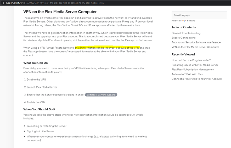

I host my PMS on a raspberrypi with an OpenVPN Server, but going from clients (e.g. my phone) to the Server (RPi), but the server itself got normal access to the internet. Is your (that means PMS’s) internet connection tunneled?
General (VPN-) troubleshooting can be found here: https://support.plex.tv/articles/204604227-why-can-t-the-plex-app-find-or-connect-to-my-plex-media-server/
the articled you posted is different thing, they say " can’t the Plex app find or connect" My plex plugin for kodi running on osmc host 10.0.1.5 can connect to the PMS.
