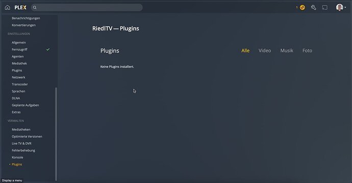

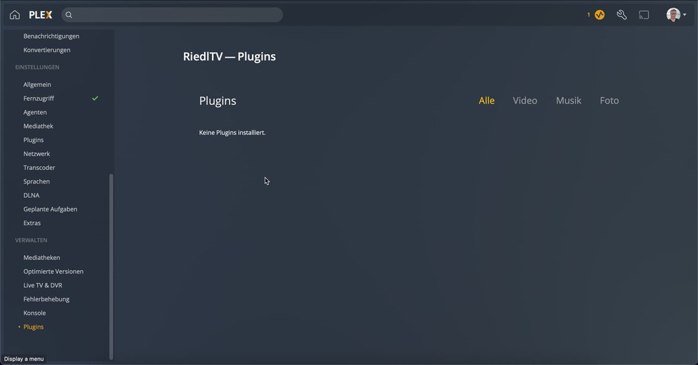

There are no plugins installed (or is there any special folder I should check?)
“Keine Plugins installiert” (German) → “No Plugins installed”
