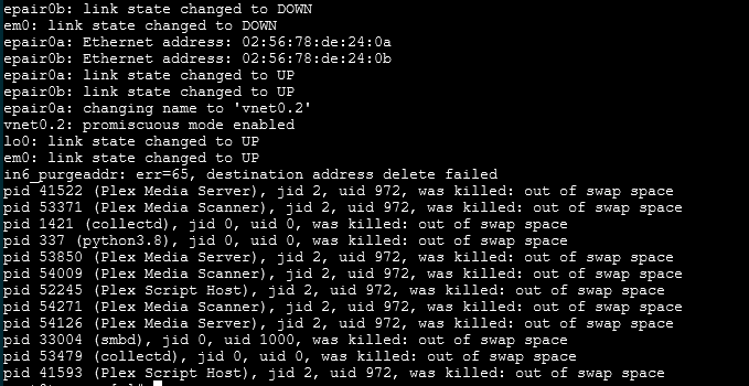

Plex is set up inside a bsd jail and works really well. When it works. Randomly the service inside the jail just stops. When I manually start it again, it works again without issue. The logs don’t show any particular error either.

Do you see any crash or kill do to OOM perhaps?
Looks at dmesg and if possible upload PMS logs, although dmesg will probably have an hint as to how it’s dying.

I think i’ve found something…
I’m going to track down this swap issue and will report back soon. Thanks for reminding me of dmesg!
So it is OOM, the process is killed cause you are running out of memory.
If your using freenas/truenas you probably have ZFS, you might need to limit the “arc” memory size,not sure if they change it,but by default it will be set to almost all your RAM,which doesn’t leave much for user processes.
Ofc limiting that affects ZFS performance, depends on how much RAM you actually have.
You should probably reboot after this happens, since smbd and collectd were also killed.

My first step would be to track down which process is using up all of the memory. Plex doesn’t normally need a ton of RAM. But if something is using ALL of the system RAM, everything will be impacted.
I have fine luck on one 8GB TrueNAS box, running multiple other jails. There’s just a few GB for services, and everybody gets along.
I’m already using this box as a NAS and PLEX service only. It has 16Gigs.
I did remove the virtual machines from this box because I saw they were eating some RAM. I’ll report back after some stability testing
