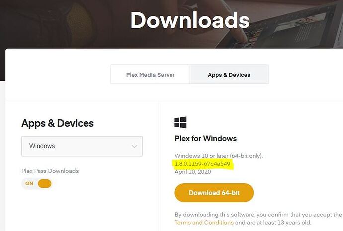

I couldn’t find a Windows Client 1.8.0, be sure you are not using the app from the Windows Store as that one is deprecated and not supported.
aw.. I meant plex player for Windows - from the website
but in the app it actually says " Version 1.6.5.1097-3bb9dc68" - sorry for this (not my fault) :wink:

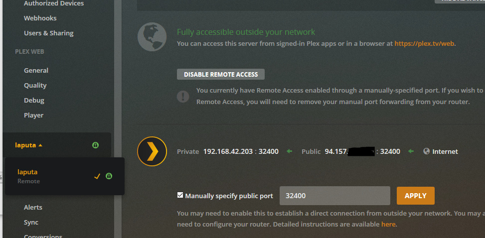

test via app.plex.tv: remote
test via https://192.168.42.203:32400/web : nearby

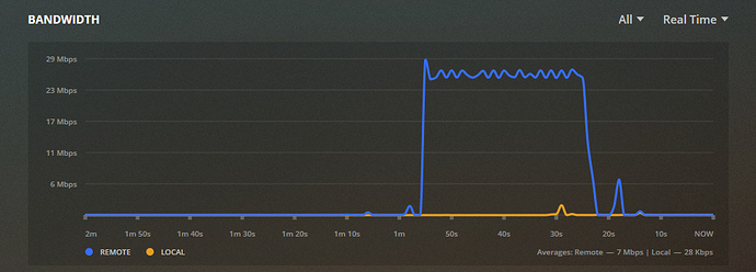

now I removed the limitations for bandwidth/transcoding and I can direct play to “Remote” but I would like to not do that. I like my friends but this is a free service and I have limited upstream so I would like to keep that limit for “remote” in place.
