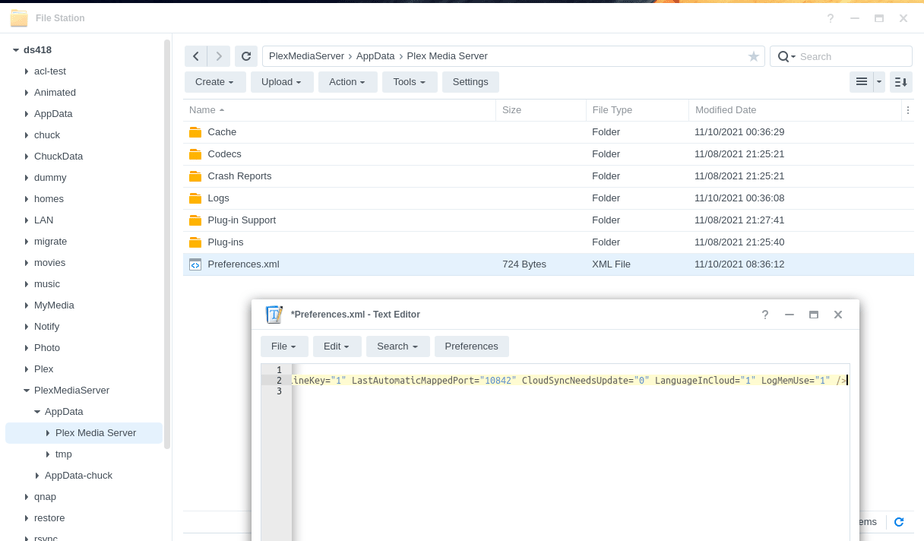

For those who are seeing Plex stop running for no apparent reason, I’d like to enable memory usage logging.
The procedure involves adding the hidden preference in “Preferences.xml”
DSM:
  1. Stop Plex
  2. Open FileStation:
  • (DSM 7) - PlexMediaServer → AppData → Plex Media Server
  • (DSM 6) - Plex → Library → Application Support - Plex Media Server
  1. Install Synology Text Editor app (if not already installed)
  2. Right-click “Preferences.xml” → Open with Text Editor

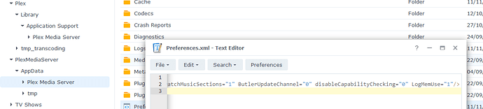

  3. At the bottom, right before the closing /> add LogMemUse="1"
  4. It will look like this:
  5. Save the file
  6. Start Plex

It is, but I just realized I have another parent Plex folder which is just ‘Plex’ that has a Preferences.xml as well. I’ll put it in there too just to make sure and report back next time.
This is how it was set up yesterday. I stopped Plex from running, edited the file, saved it then restarted Plex and waited for the issue to happen again.
