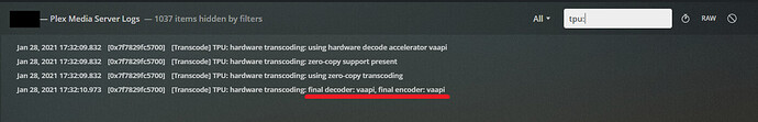

To see if your GPU is in use for transcoding:
  • Using Plex Web, go to Settings → Console
  • Filter for TPU:
  • Play a movie. Force a transcode if needed.
  • You should see NVDEC/NVENC for the decoder/encoder if Plex is transcoding with the 1070.
