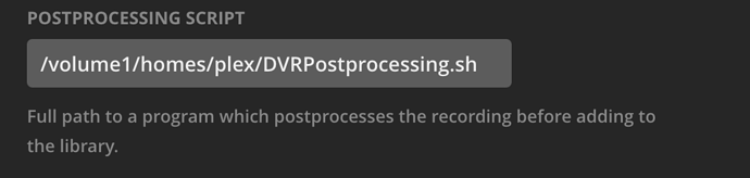

I’m trying to use the Postprocessing Script feature on the PlexDVR
to process the .ts files recorded from my HomeRun Quatro. I want to automatically reencode them as h.264 mp4 files using ffmpeg.
ffmpeg -i $file.ts -acodec copy -vcodec libx264 -f $file.mp4
I think this may be the right ffmpeg code to do the job, but I’m not sure of a few things.
  1. I imagine this needs to be saved in a .sh file and put on my synology, but I’m not sure of the filepaths for Synology Diskstations. I can’t seem to find that anywhere. volume1/homes/plex/filename.sh or something like that?
  2. How does it know what file to convert? Does Plex send it as an input, and if so, did I call it correctly?
  3. do I need anything other than the ffmpeg code in the sh file?
Sorry but I don’t really know what I’m doing with ffmpeg. This is a weak spot. I got everything else working through and would be super excited if this got going too.
Finally, where would I submit transcode after recording as a feature request? Presumably with the removal of commercials option encoding is done.

Sure, the Syno part is easy.
If you created a single RAID set, then everything is in /volume1/<sharename>/ (wherever you assigned).
If you have a movie, for example,
/volume1/movies/Avatar (2009)/Avatar (2009).ts
If a series,
/volume1/tv/Star Trek: Discovery/Season 1/Star Trek: Discovery - S01E01 - Battle at the binary stars.ts
The volume depends on how you provisioned the syno. If each disk is JBOD, then Disk 1 = volume1, Disk2 = volume2, etc

Because I couldn’t find it anywhere else, I wanted to make sure I posted the solution (lots and lots of trial and error)
And the DVRPostprocessing.sh file reads as follows:
#!/bin/bash
[ $# -ge 1 -a -f “$1” ]
ffmpeg -i “1" -acodec copy -vcodec libx264 "{1%.ts}.mp4”
rm “$1”
This converts the mpeg2 video in the ts file to h.264 and repackages the file as an mp4. It worked perfectly but it does take a LONG time on a DS418play. A 5 min test file (I started the recording with 5 min left in the episode) took about 17 min to convert. I’m now considering dropping the additional $130 to return my 418play and upgrade to the DS918+ which has a quad core processor. But this should work on either.
Actually, I added an additional parameter to the ffmpeg line and it’s MUCH faster now. Not as good compression, but still under of the 50% the ts files
#!/bin/bash
ffmpeg -i “$1” -acodec copy -vcodec libx264 -preset superfast “${1%.ts}.mp4”
rm “$1”
Quality across the preset can vary though it’s generally the same. The file size increases with the faster encoding though.
