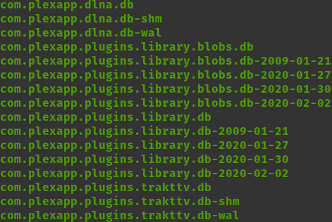

are there any database backup files (dated) ones in there?
This is not sounding good at all… Does this mean I won’t be able to recover anything and will need to start plex from scratch?
There are quite a few DB files with dates. I’ve included a screen shot of the folder.
SS DB
Will I at least be able to still use plex somehow instead of reinstalling the OS? I wish I knew where things went wrong so I can avoid them in the future.
You have DB backups. There’s a chance.
  1. Manually invoke SQLite3 to perform an integrity check of each file (except the SHM and WAL)
  2. If any of the com.plexapp.plugins.library.db.XXXXX pass, then you stand a chance of copying that (on Linux) and overwrite com.plexapp.plugins.library.db .
  3. Don’t forget to make the db owned by plex:plex

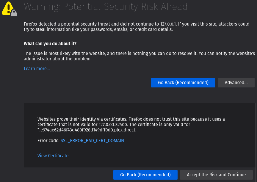

Looks like everything is working as intended as far as plex reaching the drive contents etc! Thank you so much for your help! There is 1 issue that I noticed (so far) and that deals with the certificate for 127.0.0.1:32400/web
When trying to go to https://127.0.0.1:32400/web I receive a certificate error saying the cert is insecure. I’ve included a screen shot of the issue and was wondering how would I go about making my connection secure? Would I need to somehow regenerate a new certificate for PMS to use?
Plex.direct – that’s the private domain Plex uses.
You have a cert on the box?
Not that I know of. Is there some sort of tutorial on how to add one and have plex use it?
plex.direct is a private domain which Plex overlays on top of any other domain defined for your lan.
The error message you posted implies that the host certificate already installed on the computer (which governs the machine itself) is at odds with the overlay.
FireFox doesn’t know of plex.direct (it doesn’t know about it out-of-the-box)
First, read up on these two support articles.
If these are not within your comfort zone and you fully understand
then I suggest considering adding a Firefox exception for domain plex.direct .
plex.direct is only applicable to the local lan. it’s non-routable on the internet (because your LAN is RFC-1918) … Is your LAN RFC-1918 compliant?
https://support.plex.tv/articles/?s=certificates&search=support_articles
Sorry about that. I thought it was using the cert to access the internet. I didn’t realize the cert was for my internal network. Yes my IP is 192.168.X.X
I’m just going to leave that alone if that’s just internally.
