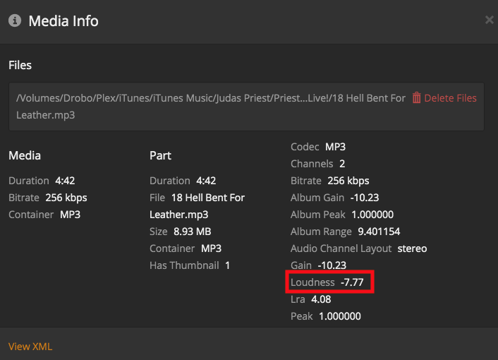

There are often times that I will rip a CD, then years later find bonus tracks from our Library’s Freegal service. Combining the bonus tracks with the CD tracks ultimately makes the CD tracks MUCH lower in volume because the downloaded tracks are hotter.
Track 1 from CD:
Track 14 from Freegal download service:
My only recourse is to download the entire album from Freegal so all the tracks come from the same ripping source.
Per track leveling would be nice. I already had a similar discussion with Elan concerning this and received the same answer. The needs of the many outweigh the needs of the few, or the one. Live long and prosper :vulcan_salute:
