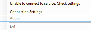

When I started having problems (could not access Plex outside the network) I uninstalled 1.1.4 and downloaded 1.1.5. Now when I try to install 1.1.5 I get this pop up window.. Not sure where to go from here.

Try the steps outlined here http://forums.plex.tv/discussion/comment/1616913/#Comment_1616913
I’ve been there, those settings are all correct. This is part of the Plex service installation. it won’t let me finish the install.

Anything in the windows application event log at the time of the error ?

I think I got it. It was set to login with “This account” instead of “local system account” under the login tab of the Service properties.

Thanks for the responses. All is up and running. Once that calmed down I took another look later in the day with a fresh eyes. And there it was, the service itself needed a port open on the firewall. Now I can access the server, which is running as a service in Windows, from outside my local network. Thank you one and all.
