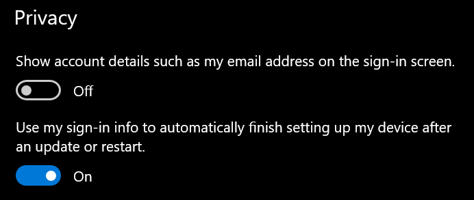

No, I’m only suggesting that you ensure the setting above is enabled. There are limitations, as I mentioned.
You mean like this:
That does not work as this is how the machine was set from the beginning.
Fair enough. I re-tested on Windows 10 Pro and it still works there as well (PMS not available after restart with it disabled; PMS is available after restart with it enabled without logging in). Microsoft mentions a couple of things in the article I linked originally which could cause this to fail, so perhaps that’s a contributing factor.
