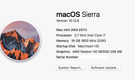

For some reason PMS is transcoding my stuff. I have disabled video stream transcoding. I think the Mac Mini from 2011 cannot handle the load, but before I splash out on new hardware I want to understand why the transcoding occurs. I have Direct Play and Direct Stream enabled, video stream transcoding disabled - so in theory only Audio should be transcoded.PostcardKillings.xml.zip (10.9 KB)

From what I can see, the audio stream is being transcoded for compatibility with your PS5, you also have subtitles selected which I believe forces the server to transcode the video also. Try turning off the subtitles or selecting a different audio stream. and you may be able to watch your stuff without having to make massive changes right away. Your Mac mini just doesn’t quite have the gusto to pull of that transcode as it is equipped with a second-gen i7-2620M. That particular chip is old enough that it won’t be capable of hardware transcoding and it definitely doesn’t have the booty to perform those transcodes in software. I think either it’s time to invest in better clients that won’t force a transcode like the Nvidia Shield Pro (not the tube, the tube is garbage), invest in better hardware for the server that can actually perform the transcodes you are asking of it, or re-rip your videos and audio into formats that won’t require transcoding by your already existing clients.
Playstation are notorious for being terrible players, and I agree that re-encode would be the way to go, or get a different file with 264+AAC, but I disagree about the hardware. I think he’s machine can be an excellent server. I have an old Lenovo with i5, and its QuickSync never disappointed.
His machine features a processor that is over a decade old, is a mobile variant, and falls below the threshold of what the Plex community knows works well for QuickSync transcoding. (Most of the community will tell you if you are below 6th gen the experience will not be great, and 2nd gen Sandy Bridge is known to be particularly rough.) I should have said it isn’t capable of hardware transcoding well, as it technically can but the experience is going to be pretty crummy. Whatever you may think doesn’t change that it is old and not capable of performing the transcodes that are being asked of it evidenced by the fact of the CPU spiking and rendering the machine basically useless. That does not make for an objectively “excellent” server. If transcoding was never asked of it, it would probably be a decent server for a while still, but as that is usually not a realistic scenario it is very likely that upgrading the server will leave OP with a much better experience overall. I would argue that sacrificing the quality of your audio to make up for weak server hardware when it is reasonable to expect 10+ year old hardware to need upgrading is not a good solution. A $300 Asustor AS5202T or Qnap TS-251D (I’m partial to Qnap personally) would absolutely crush what he is asking of his server. Alternatively, if he needed something like the Mac Mini he could buy a newer NUC in the $500ish range and get a WAY more powerful machine, or a generation old Mac Mini and again have a WAY more powerful machine. All of those scenarios lead to a better experience than trying to limp along old hardware like that.

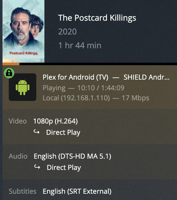

I’ve been reading some more and I agree I should try to stay away from Transcoding. Apparently that happens when your audio is transcoded and you have subtitles enabled (I guess due to lipsync issue in the past). So if I can Direct Play both Audio and Video and only use SRT subtitles then I should not have PMS transcoding.
On my way to pick up a Nvidia Shield Pro to test that teory.
OK!! The Shield solved one part of the problem and no more transcoding. The scrubbing forward and reverse is so much better than anything Plex I have ever experiences on my setup. I’ve been missing out. Even the audio quality has taken a hike up and that’s just with AC3 5.1 - nothing fancy. Thanks Blkbyrd, I would not have gone this route without your suggestions.
