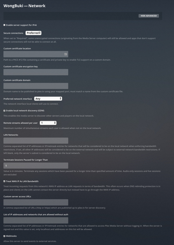

Are you using any plugins, DLNA, IPV6, or CGNAT
Describe your network layout. Describe how the mini is configured.
Screenshot your Settings - Show Advanced - Network please.

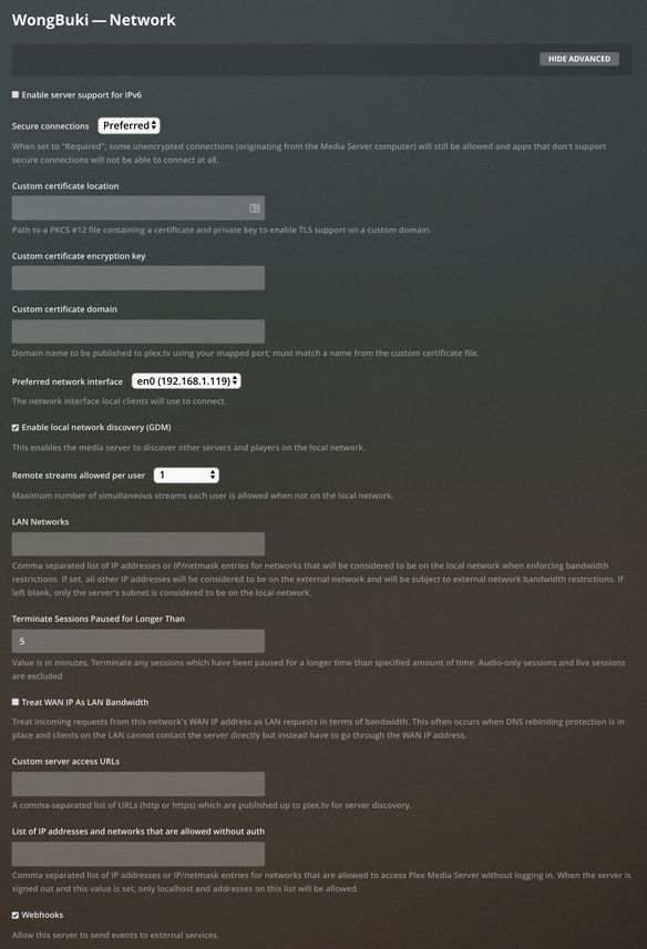

Prior to that, the system was flickering back and forth between your real private IP,
192.168.1.119 and your IANA rfc3927 link local IP 169.254.xxx.yyy
It repeatedly says internet connection is lost, then we appear to have regained.

Here’s that screenshot of Settings - Show Advanced - Network:
I don’t recollect adjusting any configurations here but for the Remote streams allowed per user, but based on the findings that you noted, I’ve a hunch that the following options might be in party with what’s going wonky?
  • Preferred network interface > Any
  • Treat WAN IP As LAN Bandwidth
Under the dropdown, I only have the options Any (presumably the default) and the physical interface. Is it possible that Any could be related to the IP-Ping-Pong? Perhaps it’s just a red herring.

there is no need to enable this unless you know you are having issues with local clients the finding local sever.

Did you ever force Plex to only listen on en0 in Settings > Network > Preferred Network Interface?
Not yet. Doing so now.

Current state of Network settings:
There’s nothing significantly different in the config, or router settings from before when PMS was solid as a rock, it all appears (perhaps anecdotally) that it went to heck after upgrading to the new beefier MacMini. Clean install be damned.
This vexes me to the point of new grey hairs sprouting. :grimacing:
