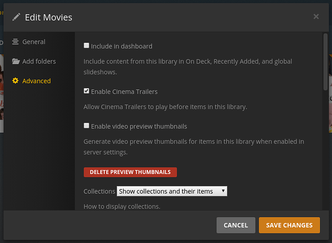

Do you ever user the chapter thumbnails?
If not, I suggest turning them off and removing the ones it has created already.
With that small quantity of files, you should easily fit within a few GB of storage
No. How do I turn them off?
Uncheck the box (it is checked by default)
click the delete button.
