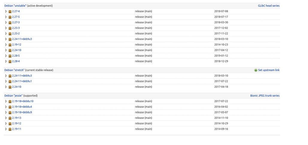

To shortcut, check your actual files
-rwxr-xr-x. 1 root root  1901676 Aug 29 06:17 /lib/libc-2.26.so*
you want libc
I am also very concerned about this: Mixing 4.8 and 4.9 GCC… which apparently comes from Debian 8?
ii lib32gcc1 1:4.9.2-10+deb8u1 amd64 GCC support library (32 bit Version)
ii libgcc-4.8-dev:amd64 4.8.4-1 amd64 GCC support library (development files)
ii libgcc-4.9-dev:amd64 4.9.2-10+deb8u1 amd64 GCC support library (development files)
ii libgcc1:amd64 1:4.9.2-10+deb8u1 amd64 GCC support library
This is beyond my Linux knowledge but here goes:
/lib32/:
lrwxrwxrwx 1 root root 12 Jun 18 2017 libc.so.6 -> libc-2.19.so
