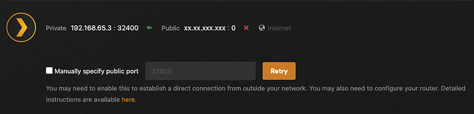

I have the latest PMS in a docker container. It is only accessible on the docker host. If I change the network_mode to “bridge”, the predictable happens and it is completely inaccessible, but “host” is hardly any better. In host, it tries to use an ip address associated with the (Mac) bridge100 interface. This isn’t routable even to devices on my home network.
(The xx.xx.xx.xx is my public ip address…)
It’s unclear where to even start to untangle this mess. Does anyone have any advice about where to start?

The Private: address shown in your first screenshot will always show the IP address inside the container and will never show your Mac’s IP address (because it can’t see it).
Setting the ADVERTISE_IP just sets the Custom server access URLs preference and so you don’t really need to set it past the first run. You really shouldn’t use the ALLOWED_NETWORKS as that essentially eliminates all security for clients on this network.
