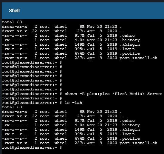

@mikec_pt i did copy paste you code, but i’m not sure if it did anything
i did try both
“root@plexmediaserver:~ #chown -R plex:plex /Plex\ Media\ Server”
and
“root@plexmediaserver:/ #chown -R plex:plex /Plex\ Media\ Server”
Capture d'écran 2020-11-21 19.11.23
Capture d'écran 2020-11-21 19.17.18
by the way i’m pretty sure the reason root own Codecs is because you told me to delete it, so when i went to put back Codecs. i was log in as root, so root wrote those files
You’re not in the right path, or in other case using " in the wrong place, but this is most certainly due to permissions, after wiping the dir PMS should re-create it again, if you move over somehting then its gonna get the ownership of whomeever moved it.
