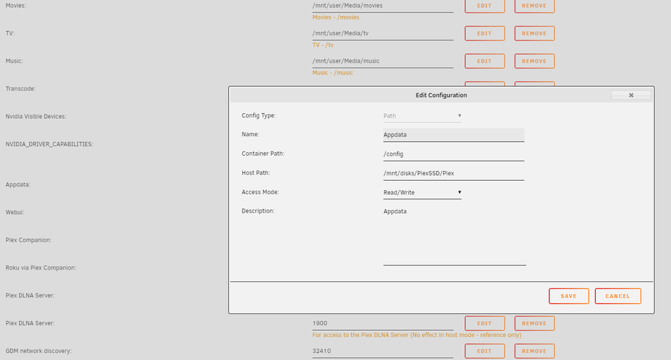

Unraid 6.8.3 - Plex Linux docker
Hardware encoding is enabled, P2000

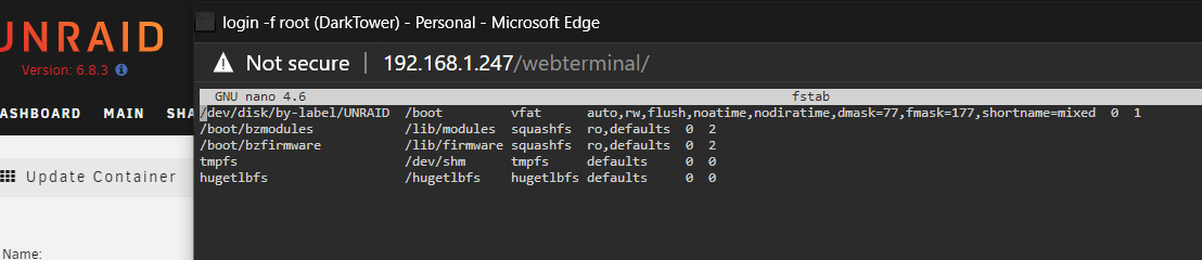

The issue is normally to do with how the mount is done - the EasyAudioEncoder binary gets extracted into temp directory and needs to have EXEC and not have NOEXEC

I read that but didnt understand it. they were mounting a CIFS share. I’m mounting a drive hosted on the same Unraid box. i tried changing my “access mode” set on the path from R/W slave to just R/W. not sure if this should be configured differently in Unraid. is this exec/noexec a file permission instead? i think i set my codec directory with the 777 permission. is there another directory i should be looking at?
I thought having the exec attribute and ensuring there is no noexec attribute are options for the mount in /etc/fstab - it is for whichever mount the temp directory is on
i dont have a /etc/fstab directory. maybe thats my issue?
i have my main directory Plex\Library\Application Support\Plex Media Server\
inside Plex Media Server i have my cache, codecs, diagnostics, logs, media, metadata, plug-in Support, Plug-ins.
should that etc directory be in my plex media server directory?

i dont think this is what you are asking for but this is how i have my mounts configured.
/music <-> /mnt/user/Media/music
/transcode <-> /tmp
/config <-> /mnt/disks/PlexSSD/Plex
/movies <-> /mnt/user/Media/movies
/tv <-> /mnt/user/Media/tv
can you make sure you have exec and not have noexec on the mount attributes
and please do not disable debug logging when you need to report issues and always attach the full logs zip rather than extracts - otherwise we waste a lot of time guessing of what might be the issue
I didn’t relies I could upload the zip file. see attached. i have the /config mounted with the access mode set to Read/Write. attached screenshot

Can you locate the /etc/fstab on the Linux system -I believe all mounts store the info there

and could you look for the /etc/fstab file and see what it has for that mount
I am running Plex in a Dock which runs off of Unraid. that screenshot is of the docker configuration. if i go into the shell of Unraid i see the file you are talking about, i did a nano fstab and this is what i get. nothing related to the mount. docker probably uses something else to mount with.

So you need to look into that and as far as I know, we need to see an entry in /etc/fstab for your mount confirming that EXEC is set and there is no NOEXEC attribute for the volume
