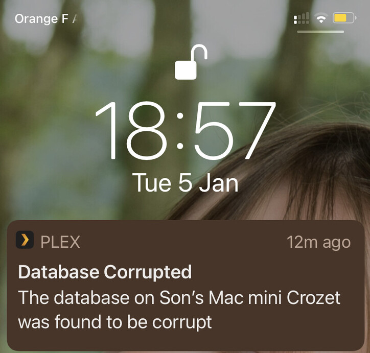

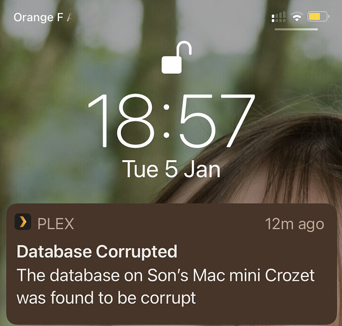

I also regularly (even prior to that metadata folder move) get a message on my ipad/iphone that my database is corrupt, but I did not notice any issue running the server and watching content.
However, my Plex server seems lately to crash without announcing, I notice it only when I want to access a media and I see it is no longer running.
Then I restart it manually without any issue.
So I am trying to assert whether the database corruption is the source of that “silent” crash
I tried to apply the steps indicated in
Not sure if it was successful:
