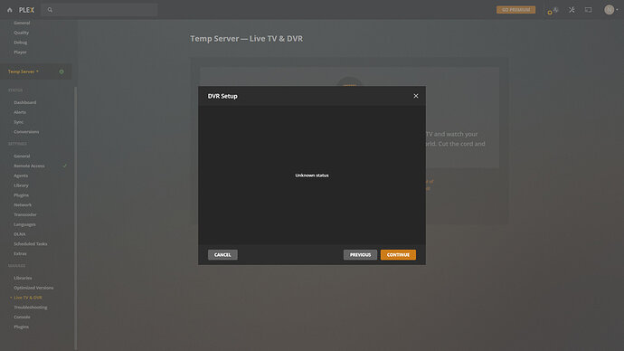

I’m still having an issue with the XMLTV guide though, I think the XML file might have some errors, because it says “Unknown status” when I try to upload the XML file. I’m still investigating this and will post an update when I find a solution.

I’d also like to add that the XMLTV error I was witnessing on PLEX was likely due to adding too many episodes to the channels. What the limit is, IDK, but right now I only have content going about 48 hours into the future, and PLEX now reads the EPG info just fine.
Did some tinkering, apparently PsuedoTV will only be able to write the XMLTV file if the schedule lasts shorter than a full week. You can check to see if it worked properly by clicking into the channel after updating it, and seeing if it says “Invalid date” next to any of the titles later on.
