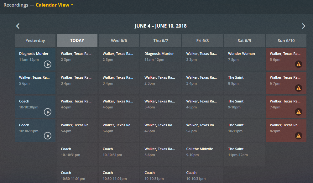

@DaveBinM I have recently seen the exact same thing. I must also say for the last 3 months with the updates my setup has been rock solid so this was a rarity lately for me. Same error, no explanation as why, no conflicts i can see, nothing in logs. I have included the screen shot and logs right after a guide update. Show is Walker Texas ranger. HDHomerun OTA devices. Windows server, Latest plex pass release.

Thanks @tachtevrenidis that worked but also had to update guide. It thought the episodes were recorded this past Sunday even though I initially added them to record after they had aired that day.
Unfortunately I couldn’t find anything in those logs that hinted as to why. :confused:
FWIW i think that Plex uses the exclamation mark on a revording for a lot of different causes and that is the cause of confusion. Of course there is no way to know what/why the exclamation mark is there (for) so it makes it even harder. For example I have seen the ! when something that you set to record as part of a series will not be recorded because the same exact episode will be recorded prior (but has not recorded yet). This is a totally legit reason but unless you are versed in this, it can leave you puzzled. MCE did a great job explaining to you why something would not record.
