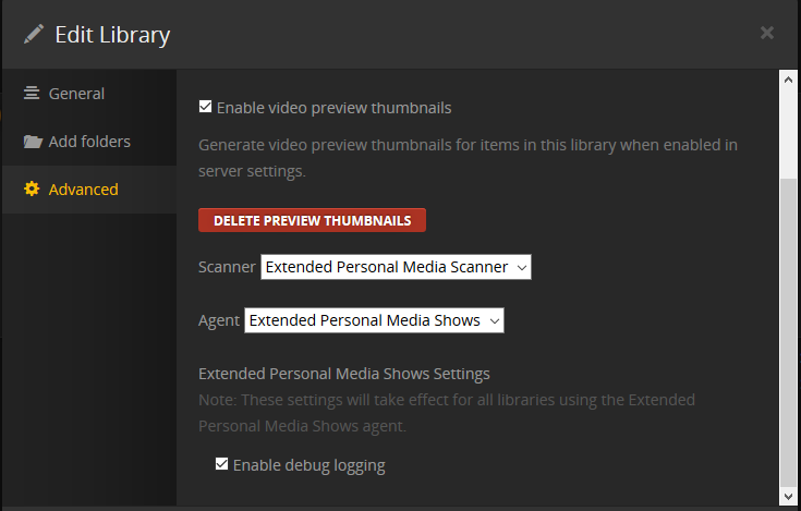

@mrkaymrkay I tested the directory structure that you posted on my test system and I am seeing separate shows and episodes being created by the plug-in. Can you ensure that you have done the following:
  • Installed the Extended Personal Media Scanner - details are available at the top of this thread
  • Installed the Extended Personal Media Metadata Agent - details are available here: https://forums.plex.tv/discussion/83440/rel-extended-personal-media-shows-agent/p1
  • Create/modify your library to use the Extended Personal Media Scanner and Metadata agent by clicking on the library Edit button and then on the Advanced link and changing the two settings indicated by the screen capture below.
  • Update your library in Plex using the Update Library button (shown in the screen capture below).
