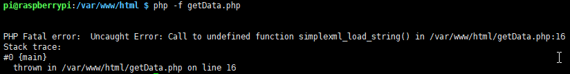

I’ve been trying to get this running but still it’s showing a black screen for me. I tried a bunch of options including permissions for cache/ and config.php and some of the ones in this thread including allowing the “List of IP addresses and networks that are allowed without auth”. I get this error.
Does this depend on php5, enough for it to break it or should php7 be fine?

@ImSammy
Try changing the Client IP address to the local default IP address of: 127.0.0.1
I believe that’s what did it for me but I’ll keep looking thru my notes.
I’m not sure what that error message means other than to check Line 16 of the getData.php
I’ll check what’s on my Line 16 in the meantime.

Yeah I did try that however that would assume my RPi3 was the client which is different from the actual client.
@ImSammy When I run the php -f getData.php like you did I get the following:
Interesting so I ran the site within my QNAP NAS (where my Plex Server is located on) and it displays it working now. Maybe the issue here is that it doesn’t support the site unless it’s local @MattsShack granted that probably doesn’t make sense if you’re being able to run if off your RPi.

@ImSammy I am not sure about php7. I have a new Raspberry Pi running I will tests on before the next release.
Maybe your connectivity issues have something to do with the authentication / authorization on the server. You might want to try changing the servers network authentication settings. Check https://support.plex.tv/hc/en-us/articles/200890058-Require-authentication-for-local-network-access . It shows how to exclude an IP address from authentication.

I can confirm that the script does not work with PHP 7 under Debian Stretch. On the other hand, it works perfectly under Debian Jessie with PHP 5.
