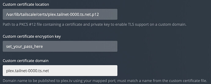

Then update the Plex->Network configuration with,
  • Custom certificate location: /var/lib/tailscale/certs/plex.tailnet-0000.ts.net.p12
  • Custom certificate encryption key: set_your_pass_here
  • Custom certificate domain: plex.tailnet-0000.ts.net

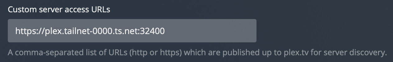

  • Custom server access URLs: https://plex.tailnet-0000.ts.net:32400

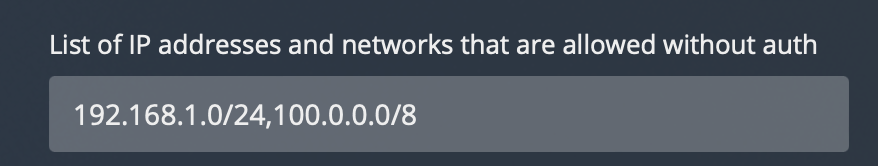

You can also include the Tailscale CIDR of 100.0.0.0/8 to LAN Networks and List of IP addresses and networks that are allowed without auth if desired.

Heads up - 100.0.0.0/8 is not accepted in allowedNetworks.
Jul 07, 2022 16:19:45.109 [0x80b025b00] ERROR - [Req#b77e] Illegal
whitelist covers multiple WAN IPs
Subnets are only allowed from RFC1918 ranges. From other ranges, only individual hosts are allowed.
