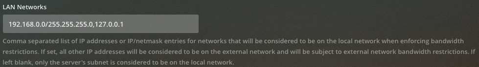

Add the 192.168.x.x network to Settings → Network (Show Advanced) → LAN Networks. This will tell Plex Media Server to treat it as local even though it is a different logical network. Here’s an example:
You may also want to add the same network to Settings → Network (Show Advanced) → List of IP addresses and networks that are allows without auth.
On the same page, there’s a setting named “Custom server access URLs.” You can use this to specify the URL to your custom domain so that Plex’s remote access knows how to reach it. More information on how to use this setting can be found in this support article.

You may have the wrong netmask configured in Plex. Typo?
I see your comment:
  • LAN Networks is set to: 192.168.0.0/16
And B, C, F are 192.168.1.1, 192.168.1.100, 192.168.1.105, which is within 192.168.0.0/16. Good so far.
However, your screenshot of Plex appears to be set to 192.168.0.0/255.255.255.0. That’s a /24, and wouldn’t include 192.168.1.x.
Try adjusting LAN Networks and ... allowed without auth in Plex?
Plex will accept CIDR notation there, but it’s allergic to ANY whitespace.
192.168.0.0/16,127.0.0.1.

About the screenshot. That is philipsw’s screenshot and not mine.
Oh funny, sorry. The screenshot looked “right enough”.
