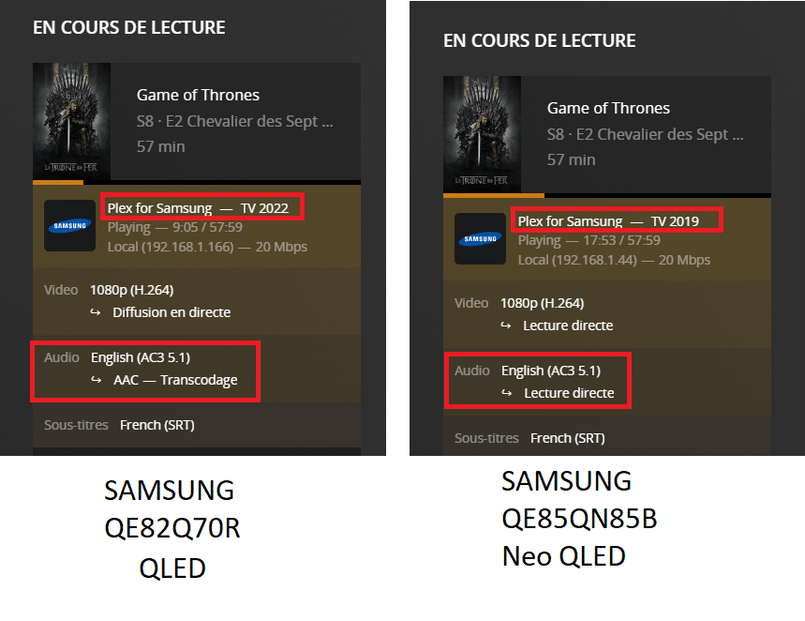

Same for me, just buy a brand new Samsung QE85QN85B Neo QLED 2022 with Plex for samsung 5.52.3 and tyzen 6.5
The Audio transcoding start and this will not play correctly, so i investigate.
Previously, this was played directly without transcoding on my last QE82Q70R QLED, with the same video file but with Plex for samsung 5.52.3 tyzen 5
So an explaination from plex will be nice
screenshot always speak more

How did you get this info by remote ? in interface navigation of the TV when it play the video ?
Yes when the video is playing obviously.
