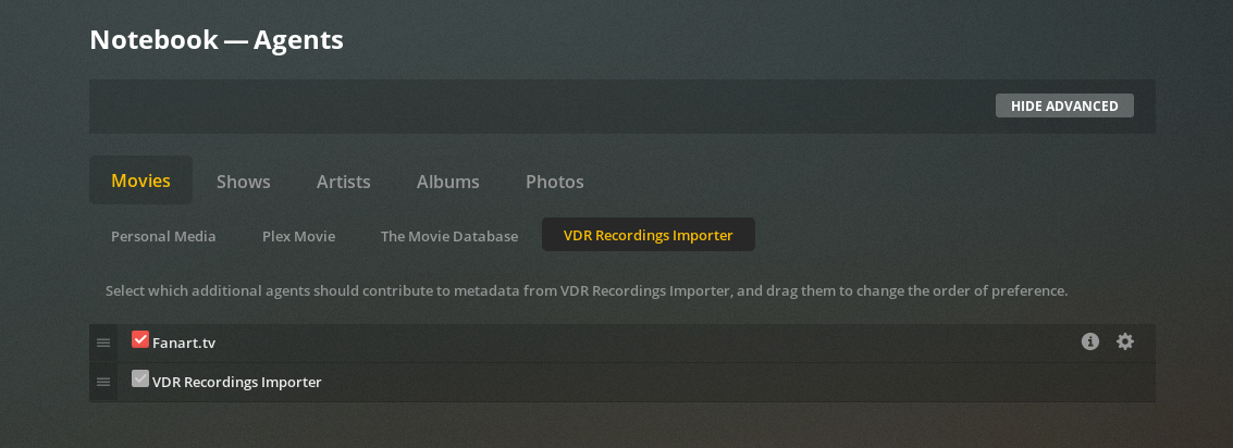

I know this is pretty old, but maybe someone has a working setup. I use VDR.bundle which works pretty good for title and description of movies. However, I would also like to have real thumbnails instead of auto generated images from the movie files.
This article states that it is possible to have multiple metadata agents and I tried to use the following setup:
I configured the Fanart plugin with my API key. However, it still doesn’t fetch images from the internet and uses auto generated images.
Does someone have a working setup with VDR imported files + fanart from online resources?
