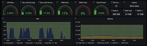

However when I try to transcode I get this
Aug 29, 2021 18:39:03.826 [0x7ffac5f09b38] DEBUG - [Transcode/FD4267D9-D53A-46A6-98E9-97AAB014C339] TPU: hardware transcoding: enabled, but no hardware decode accelerator found
Aug 29, 2021 18:39:03.826 [0x7ffac5f09b38] DEBUG - [Transcode/FD4267D9-D53A-46A6-98E9-97AAB014C339] TPU: hardware transcoding: final decoder: , final encoder:
And my CPU shoots up immediately
Restarted the whole system, deleted and recreated the containers, etc. I’ve tried h264 and hevc video formats.
Any pointers what else can I debug?
