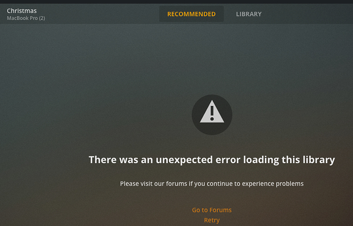

Some Libraries w/ MP4s Won't Load Anymore
Server Version#: 1.19.1.2645
Player Version#: 4.22.3
Mac and Roku TV on the same Ethernet.

First, turn off verbose logging. Debug logs only unless requested otherwise. Verbose logs generally capture too much data and wrap too quickly to see the issue. Reference: Reporting issues with Plex Media Server.
Second, looks like you’ve a corrupt database (search the Plex Media Server.log files for sqlite). See Repair a Corrupt Database. You can also try restoring the db if you’ve a known good backup. See Restore a Database Backed Up via ‘Scheduled Tasks.’
Apr 19, 2020 10:20:32.885 [0x70000fc73000] ERROR - SQLITE3:0x1078bdba0, 11, database corruption at line 65066 of [bf8c1b2b7a]
Apr 19, 2020 10:20:32.885 [0x70000fc73000] ERROR - SQLITE3:0x1078bdba0, 11, statement aborts at 3: [DELETE FROM 'main'.'fts4_tag_titles_segdir' WHERE level = ?] database disk image is malformed
Apr 19, 2020 10:20:32.885 [0x70000fc73000] ERROR - SQLITE3:0x1078bdba0, 11, statement aborts at 10: [update tags set parent_id=:tags_parent_id,metadata_item_id=:tags_metadata_item_id,tag=:tags_tag,key=:tags_key,tag_type=:tags_tag_type,tag_value=:tags_tag_value,user_thumb_url=:tags_use
Apr 19, 2020 10:20:32.885 [0x70000fc73000] ERROR - Exception inside transaction (inside=1) (../Library/MetadataItem.cpp:6525): sqlite3_statement_backend::loadOne: database disk image is malformed
Apr 19, 2020 10:20:32.885 [0x70000fc73000] ERROR - Exception loading item 'Mr. Blandings Builds His Dream House' from bundle: sqlite3_statement_backend::loadOne: database disk image is malformed
Thanks for the time you took to respond!
  1. Verbose logging was not on.
  2. I tried all the database rebuild options, finally restoring it from a Time Machine backup when I knew the database was fine. Same problem. And, can’t find something called sqlite much as I search.
This is a puzzle.
I just dumped the entire Plex Plugin folder and recreated my libraries. Thanks for your time, I really appreciate it.
Sometimes the database repair does not work and you have to re-create the libraries. It can be a pain, but glad you have things working. Cheers.
