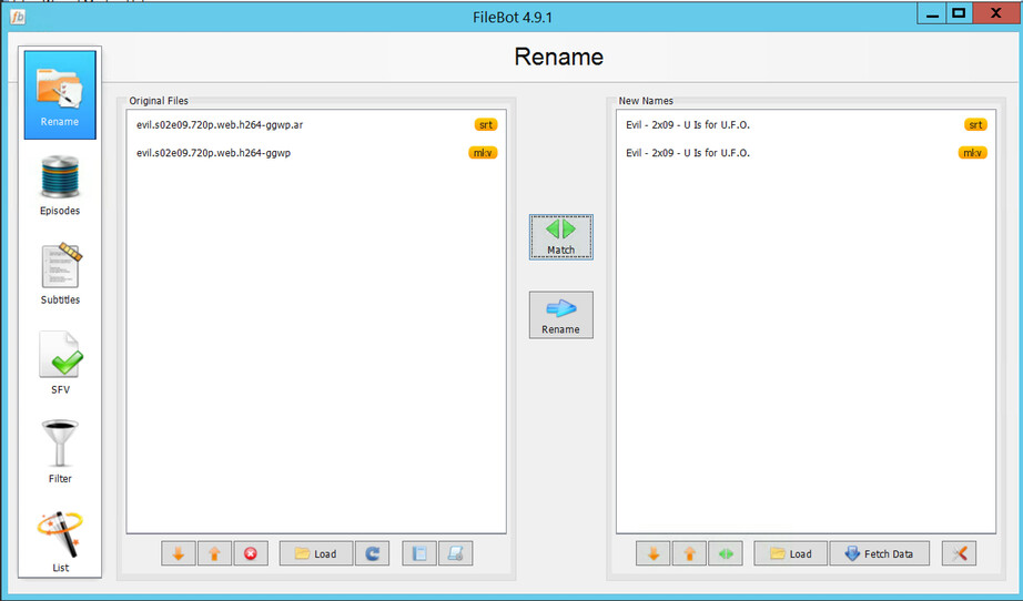

you can rename your files fast and easily by using third party application called: Filebot, it will rename 100s of files in 20 seconds.

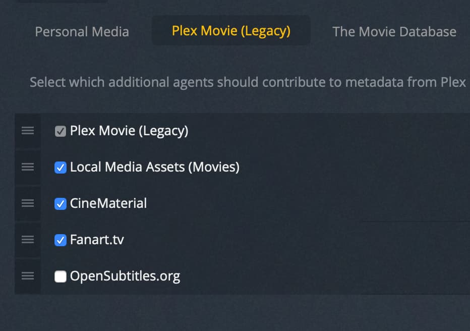

when i revert to legacy no files effected even the names not renamed, but i am using this setting inside the server agent setting like photo attached, try to arrange them like how i did inside the photos and hopefully will maintain your files again.
The bad matching only occurs with the legacy selected. I have too many movies to fix embedded titles from my rips. I’ll just have to wait for them to fix the problem. My file structures and naming conventions are fine but your explanation helps me understand what was happening in this instance.
Will filebot rename embedded titles?
It doesn’t seem to do that at all with the Plex Movie agent selected (rather than Legacy). I’ve never had an issue with it selecting an embedded title instead of the file/folder name.

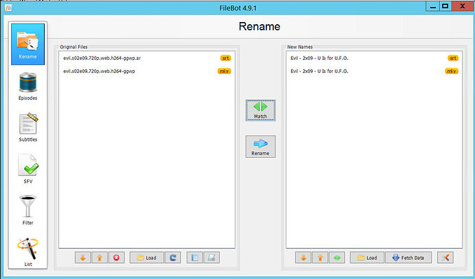

filbert reads Movies and TV Shows from IMDB and many more sources, 1 click and it will rename your files like how they must be, for example:
evil.s02e09.720p.web.h264-ggwp
with filebot:
Evil - 2x09 - U Is for U.F.O.

Reverting back to the legacy agent fixed it for me.
