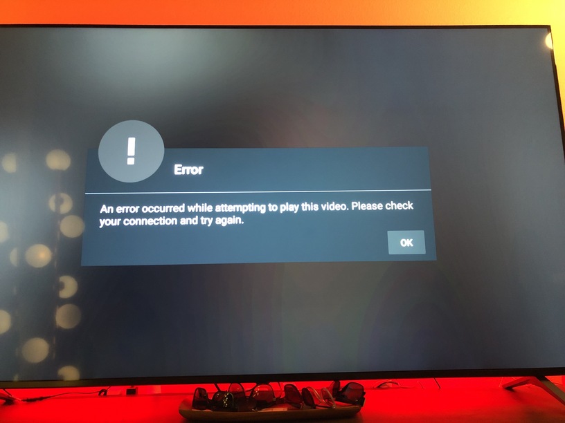

Please HELP, I just noticed that currently I unable to play trailers for my movies. I noticed this just yesterday, I added a couple movies and had trailer available yet when I clicked to play trailer on my NVIDIA shield plex just hanged then after gave ERROR “an error occurred while attempting to play this video, Please check your connection and try again” please note I did/do have connection as the movie play fine without issue. At first I thought just an issue with these, yet upon check older movies I had in my library which I had previously played trailer for now gave me same issue. I checked on web version of plex and attempted to play trailers while using chrome browser and this also gave me an ERROR which read “Playback Error - Conversion failed, the transcoder failed to startup”. As I traced back, the only thing comes to mind I had recently updated to version 1.24.2.5000-6000 on my Synology NAS, previous version i was on was 1.24.2.4973. When checking plex site, I noticed version 1.24.2.5000 seems to be pulled out.

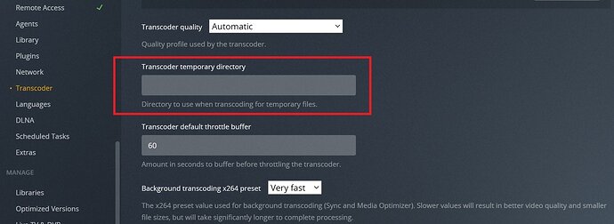

Question, should there be a default folder path on the red outlined on image??

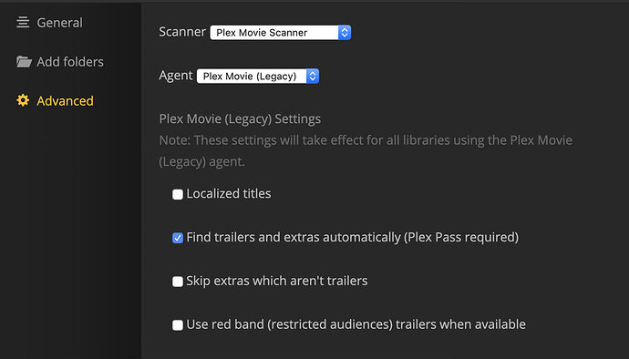

Hi, i have the same issue, but i went back to use the legacy agent and that fixed it, i think the issue started when everyone started to upgrade from legacy agent to the new plex movie agent.
try the legacy and refresh your library and trailer will back to work again.
this is the best solution for now till someone of the developer fix the new plex movie agent.
What is the best way to revert back to the legacy edition?
its mentioned above, after that refresh your movies and all trailers will work again.
Using the legacy agent does work, I can confirm.
that’s true, revert to legacy is the only temporary solution till they fix the trailer to be work on the new plex movie agent, enjoy the trailer again by revert to legacy agent, at least something better than nothing :slightly_smiling_face:
I did notice some strange behavior after reverting to the Plex Movie (Legacy) agent and went back Plex Movie. Upon refreshing some metadata, some titles and artwork changed (one was renamed DVD, and even a Fix Match would not solve it; I had to manually alter the title). It did allow for the trailers to work but it was a little too wonky for me to go all in on and so I changed it back.
