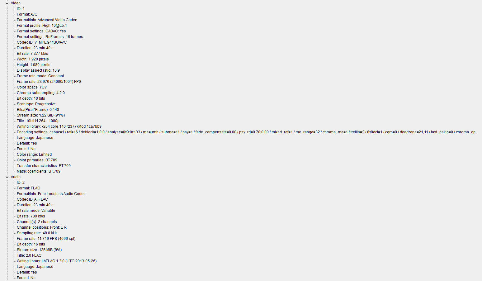

I have converted one file, and I see a slight difference but not very much. However I have a few questions.
Below are the video and audio information for the original file and my newly transcoded file.
I have noticed that the original file has a higher video bitrate (and size ofc) and the audio seems to be of higher quality as well as FLAC is a lossless format.
File size is of no interest to me, so I would like to match the original bitrate (and quality). I think my AAC was set to 160 kb/s, compared to the 739 kb/s on the original FLAC.
Also should I use High over Main? What level should I be using? I see 4.1 a lot but what about the higher ones? My encoding preset i set to “Fast”, It took roughly 10-20 minutes for 1 file with 2 pass encoding. Is a slower one worth it?

In options / advanced you can lower the priority if you need to. But because it´s a render it will try to use 100% if there isn´t anything else of importance. If you want to keep the audio on the original format just select Auto Passthru.
About the bitrate you can match it to whatever you want as long as you don´t go over what the raspberry can handle (30mbps total for audio+video). 5000kbps for video its not a blueray quality but it´s much higher than what you might find from netflix, something downloaded or broadcast HD.
I have never used anything over 4.0 for h.264, I haven´t tested the limit
Also, use the preview option. It will help you a lot for finding that sweet spot.

All my anime downloads are 1080p blu-ray, however anime has a much lower bitrate than a regular movie for example would. I haven’t seen any of them go above 10000 kb/s, whilst my movies are anywhere from 20 Mb/s to 50 Mb/s. By the way the rPi has no problems whatsoever playing those files, even the largest ones work fine. But if I transcode a source file with 7000 kb/s to for example 9000 kb/s what would happen? I doubt the quality will go up.
I have checked and all of my 10 bit files are High 10@L5 or 5.1 and the 8 bit ones are High@L4 or 4.1 so there seems to be some kind of relation between those bit depths and levels. Both 4 and 4.1 seem to work perfectly fine though on the rPi.
EDIT: An official response states that the rPi supports up to Level 4.1 and theoretically a maximum of 62.5 Mb/s.
