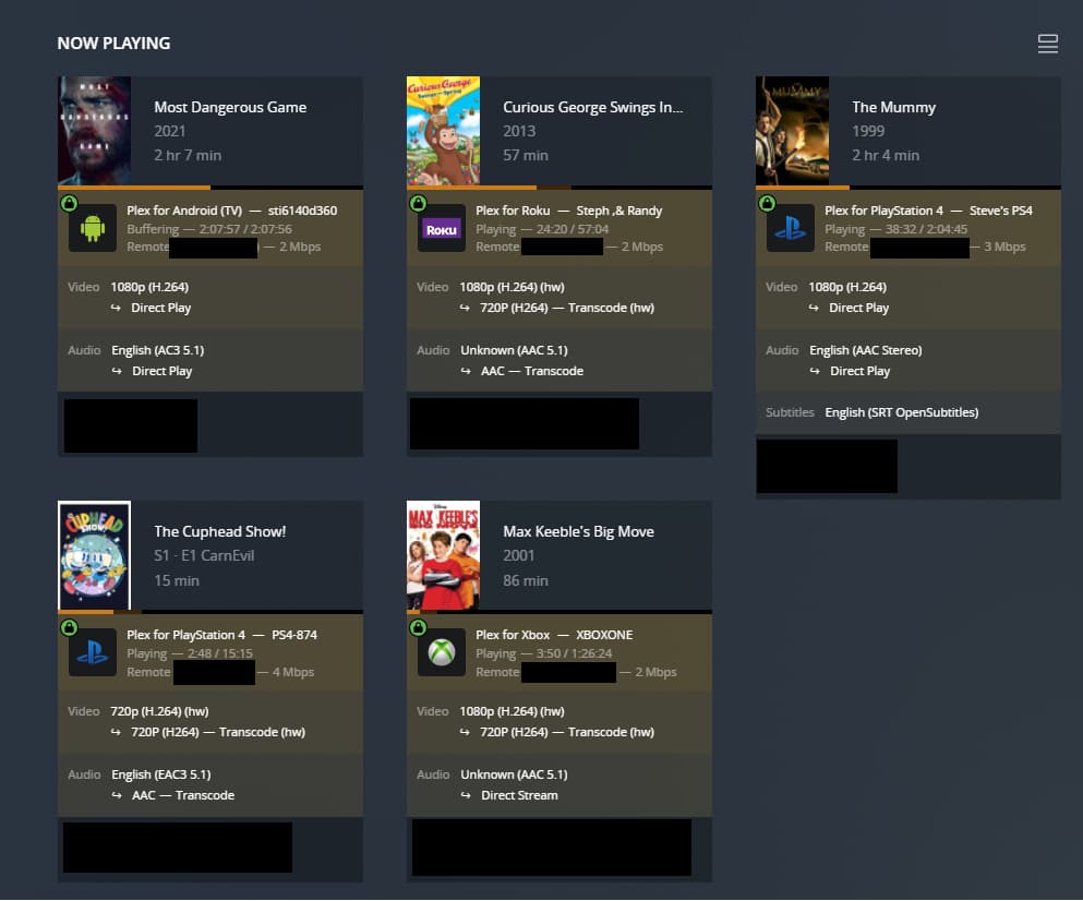

Ok. I see that the server is choosing to transcode from 1080p to 720p even when I have a 720p version available. Can someone please explain why? If it is something I am doing wrong please let me know as I don’t want to be arbitrarily using more power than necessary. I included updated server logs as well as a screenshot of the two films transcoding. You can see in the logs that it shows both resolutions available and deepanalysis=6. Thanks
Plex Media Server Logs_2022-02-18_11-32-08.zip (6.9 MB)
