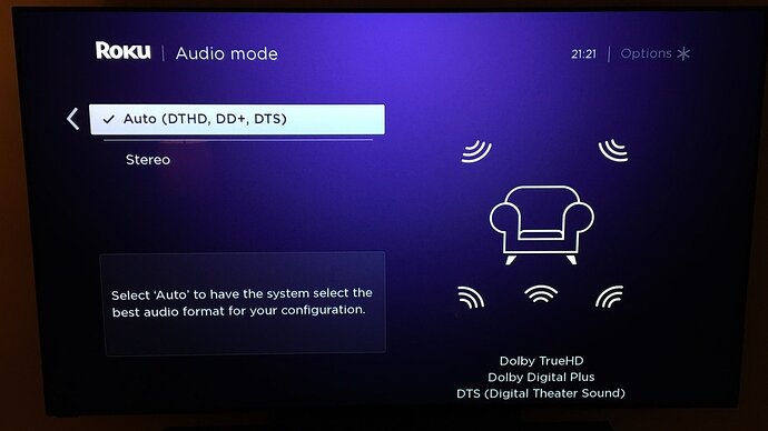

I have hooked up my Roku Streaming Stick+ to a new Vizio SB36512-F6 soundbar and was hoping to experience Atmos (5.1.2). Unfortunately I’m only getting Dolby Digital. (The soundbar announces the identified signal.)
I have Roku system audio set to auto (DTHD, DD+, DTS). Roku is connected to the soundbar input (not ARC) and apparently it is correctly detecting that the soundbar supports TrueHD.

I think you’re right about Atmos, this is only supported on Roku Ultra, so I guess the object metadata would be ignored. But what about TrueHD? Here is a photo of the menu showing TrueHD.
I am getting some kind of sound from this TrueHD source file, I just don’t know how it’s happening. The plex server log shows:
