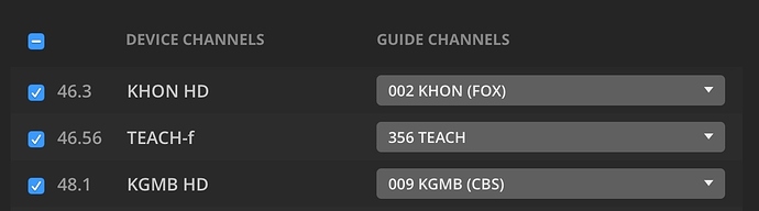

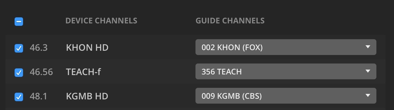

@jkaberg / @iPhonedation ~ I’m not sure I understand how we’re using the wrong channel numbers in the URLs. If you look at the channel mapping for my device:
If we used 002 or 356 (the Gracenote channel number) the recording wouldn’t work, but everything works fine over here. We specifically use the device channel number.
(Also, BTW, the reason we don’t use the URLs passed back from HDHR directly is that they are always with respect to the LAN, and we support accessing HDHR devices remotely.)
I’ll take a look when I get home from work (I based my conclusions on what @iPhonedation said). But if that’s true then my standpoint is still where it was, you should respect the URL key in lineup.json anyhow (even if it normally never changes).

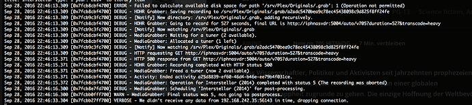

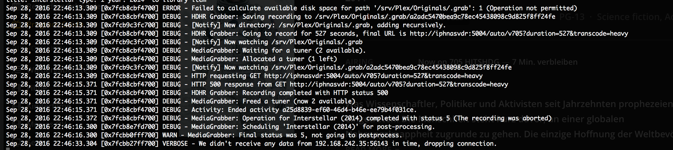

@elan - I tested it:
This is the 705 Gracenote Channel ID for Sky Cinema Hits HD. It is in fact channel 602 in my TVH instance. But the log file shows this:
See:
Is it the number of digits maybe? Just guessing … if you like you can access my setup, happy to give you an temp ssh user.
I can just say for a 2 digit channel, (12 in my setup) with a Gracenote ID of 417 it works … strange

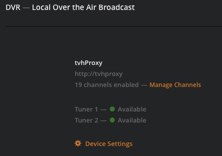

So i have nginx running on my Ubuntu machine (where TVHeadend runs), started the proxy there too.
I pointed tvhproxy to my ubuntu ip on my Mac’s (where PMS runs) /etc/hosts
Now when i add tvhproxy in Plex’s DVR settings i get a spinning loading icon while adding, but after ~5 sec i get this:
There was a problem adding the device: tvhproxy
It seems like it finds something but there’s another problem, because when i add a random IP in my LAN i don’t even get the 5 sec loading time, instead it directly shows the error.

I get the translated tvh channel list from your script. That probably means my nginx proxy isn’t working, right?
I realised that it works when i just enter 192.168.7.186:5004 in Plex DVR. Adding the tuner works flawlessly, but i can’t record anything because every recording fails.
