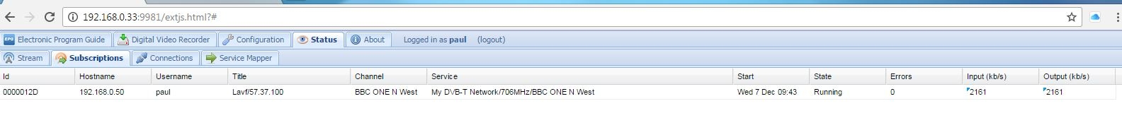

Hi all, Pretty much the same as above. I open the TVHeadend channels on my plex and I select the channel. When i look under subscriptions on TVHeadend it shows my plex as being connected and the channel along with input and output data rates, but then a few seconds later, it goes away, then after a while my plex says There was a problem playing this item. The TV Channels work OK when using a TVH Client on my phone, and my plex client will play anything that is on the media drive. Thanks
My TV Headend is 4.0.9-4 and my plex is version 2.10.10

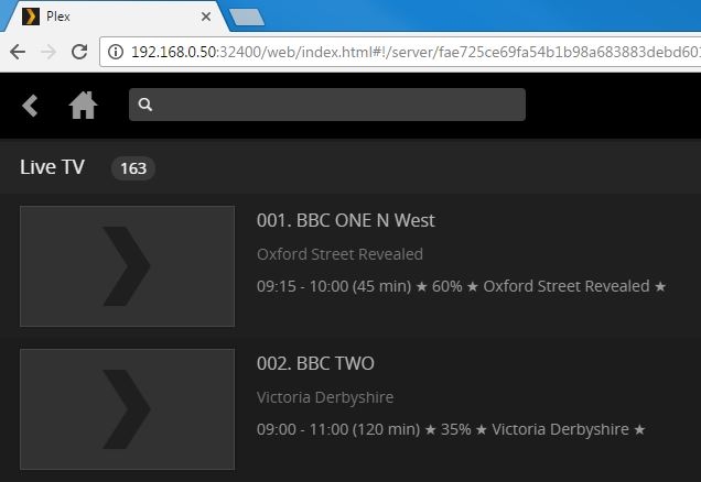

Just installed this now to test. Can verify it worked straight away over LAN in plex web using server IP as 127.0.0.1 but had to use server LAN IP of 192.168.0.3 for it to work on rasplex. Can’t seem to get it to work on Plex for Android

thanks! it worked now it plays btw the icons continue not showing :confused: and works on kodi for example
What profile should TVH be using for this? I can’t get plex to record using DVR fine, but this channel will not work even with the init.py edit. it just sits and spins out? but if i look at tvheadend, in the status it shows a connection and that it’s all fine that end? but plex just cant seem to play it
Nevermind, i used tvheadend-ng and uncommented video_codec = VideoCodec.H264, on line 348 in init.py. I also changed line 311 from mco = addMediaObject(mco, args[‘url’] + ‘?profile=pass’) into mco = addMediaObject(mco, args[‘url’] + ‘?profile=plex’)
I then added a stream profile in TVH called plex, Transcode/av-lib with all default except audio codec as “copy codec”
Hope that helps anyone that’s having a similar issue.
