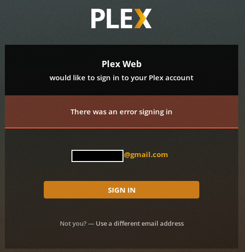

Same redirect, but after login (with email/UN) I get:
Seemed stuck in a loop for a while, but after a few tries and/or clicks of the “Sign In” button it loads. No change, no settings.

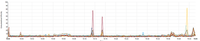

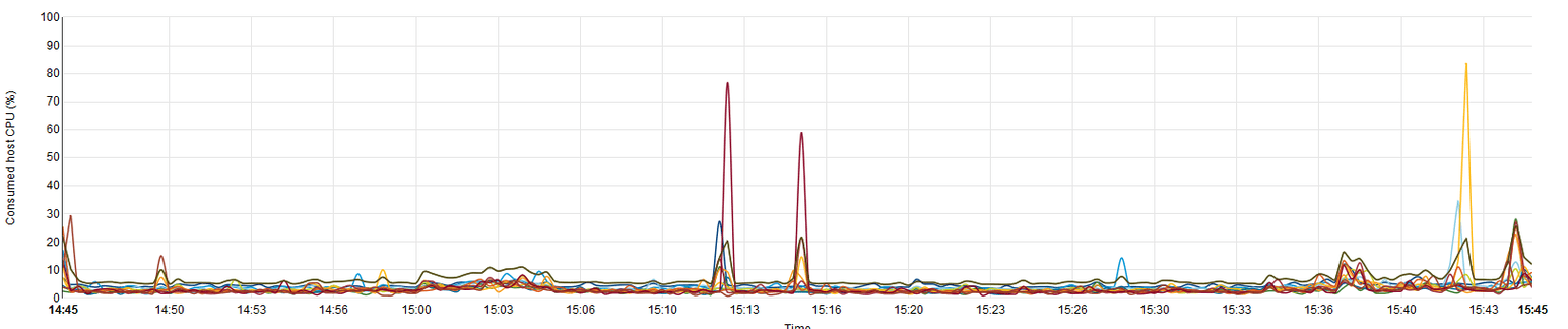

How many VCPUs are in this VM.
All indications are there isn’t enough CPU power being given.
What is the host for this VM?
Been running 1.14 or lower for several years without much issue. Seen it pulling of ~6 transcodes at a time.
ESXi 6.7 U2 virtual machine
Has access to 6 logical of an i7-5820K
