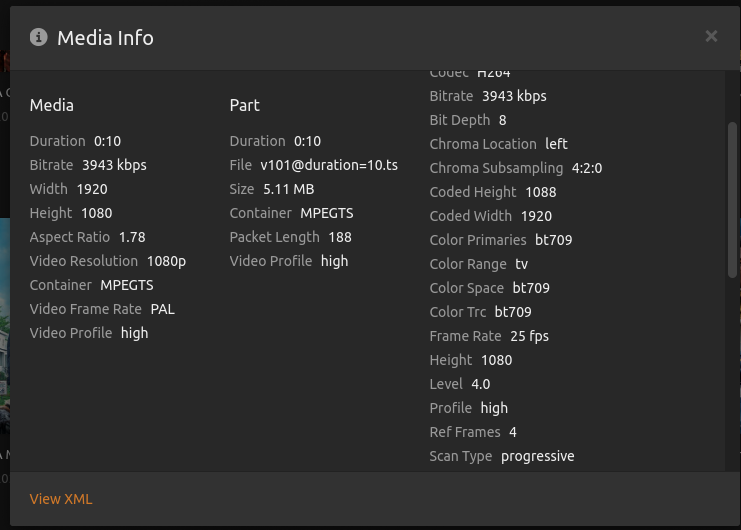

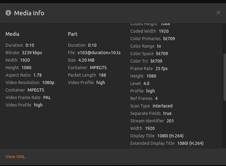

How PMS sees them.
The video streams themselves are valid.

@ChuckPa Thanks for the info. I actually tried to look at the .grab folder where the destination of the recording is and it’s just a single file. But I did see that if I work my way through the Transcoder temporary directory I can find the individual files :wink:
Just reflecting on the client side of Plex, what are we expecting it to do when it sees interlaced files? Do we know what the process is supposed to be, who does what deinterlace? (client or PMS)
[Edit] I have just ran some tests on a TV show that is/was being aired on channel 103. And it’s interesting what I got back.
  • Mediainfo on individual .grab files - they’re ‘progressive’
  • Mediainfo on final .ts files, after recording had finished, it’s “progressive”
  • Ran my own BAT file to wget the data and used ffprobe, it’s “progressive”
  • PMS identifies the file as progressive :wink:
  • When I play the file back in Plex Windows Client - it plays fine, no real issues
  • When I play back in Chrome Client, there is no interlace issues, but Chrome skips about 0.5 seconds, every ~5 seconds - it’s really annoying to try and watch - if I set Chrome/Client to auto convert, it’s fine? I think it’s worth saying this “issue” I found is out of scope for all of this, but it is an issue no matter what DVR files I play (I’ve only just found this)

The really hard part, now knowing channel 103 (ITV 1 HD) can transmit either Interlaced or Progressive, is how the heck do I find an Interlaced show? This may take some time, and trial and error :roll_eyes:
As I understand it (with a Freeview HD stream anyway), you cannot just look at the metadata header information at the start of a file (like mediainfo and Plex) to then determine if the complete file is progressive or interlaced.
It can and does switch between the two during transmission and you need to process the data on a GOP basis to determine if its progressive or interlaced.

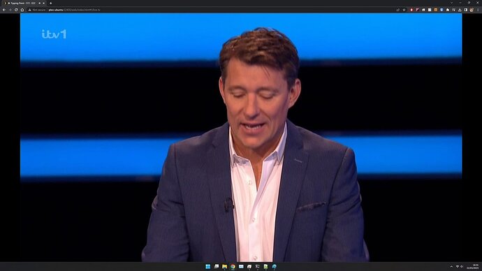

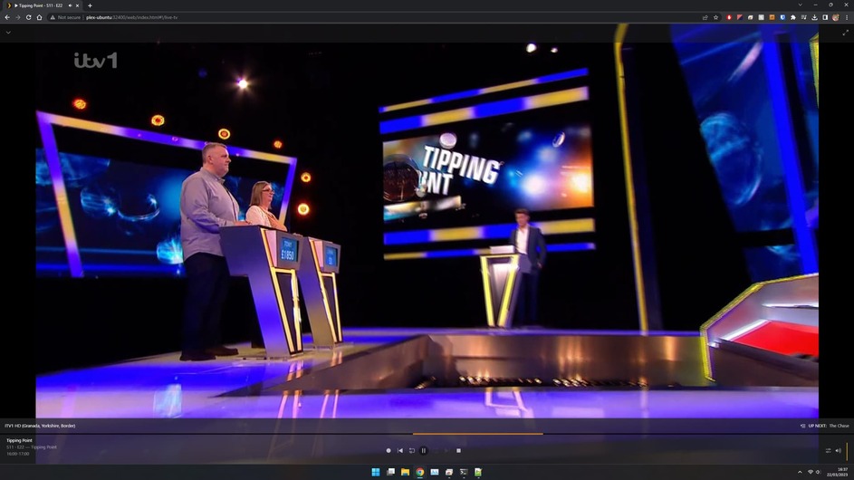

I can re-create the issue you see with interlacing artifcats playing back football footage on my Firefox browser and the PMS Linux Client (whether PMS thinks its progressive or interlaced).
The same playback on my LG TV or FireTV is NOT a problem - so why the difference ?
Simply, I suspect the hardware on the FireTV and/or LG TV are deinterlacing the signal as required.
I think you’re correct, as I know know the stream can change during transmission… I’d love to say “don’t cross the streams”, but Freeview already did that LOL

Ok, so as luck would have it, a current TV show is being broadcast in Interlaced. I think this is going to be a mute point, but I’ll share links to the files I collected. But I did note that PMS is correctly identified this short recording as Interlaced.
I will be attempting to grab more files, that hopefully span the aired show as Interlaced and I’m hoping that the commercials/adverts will be in Progressive… I’ll report back on that.
@ChuckPa here’s some more files, but they all seem to identify correctly as Interlaced.
Plex DVR .grab files (small selection)
Final TS file created by Plex (and saved to main DVR/TV folder)
Manual wget direct from the HDHomeRun
Ok, so after watching faaaaar too much of this cr@ppy TV show, I managed to collect some more data/files.
We all knew this would be the case, but for completeness, here we go… I started to record a TV show that was being aired as Interlaced; watching it through Chrome, I could see it was not deinterlacing (I took a screen grab); I waited for the adverts/commercials, and then used wget to dump out a short clip direct from HDHomeRun; as expected the small section I captured is in Progressive… At this point I stopped the recoding of the show and checked back in PMS and sure enough Plex has identified the show as Interlaced.

Here’s a link to the files I collected:
I found this really interesting… While streaming live TV to Chrome, I noted that PMS stated it was transcoding from 1080i to 1080p… I took a couple of screenshots, which isn’t great since it’s a dull tv show that does not have much camera movement, but you can see distinct horizontal lines as if it’s not deinterlaced properly?? :man_shrugging:
PMS Stats
This one is more obvious?
This is less obvious, but you can see lines over the persons face (eyes + teeth)
Another image
